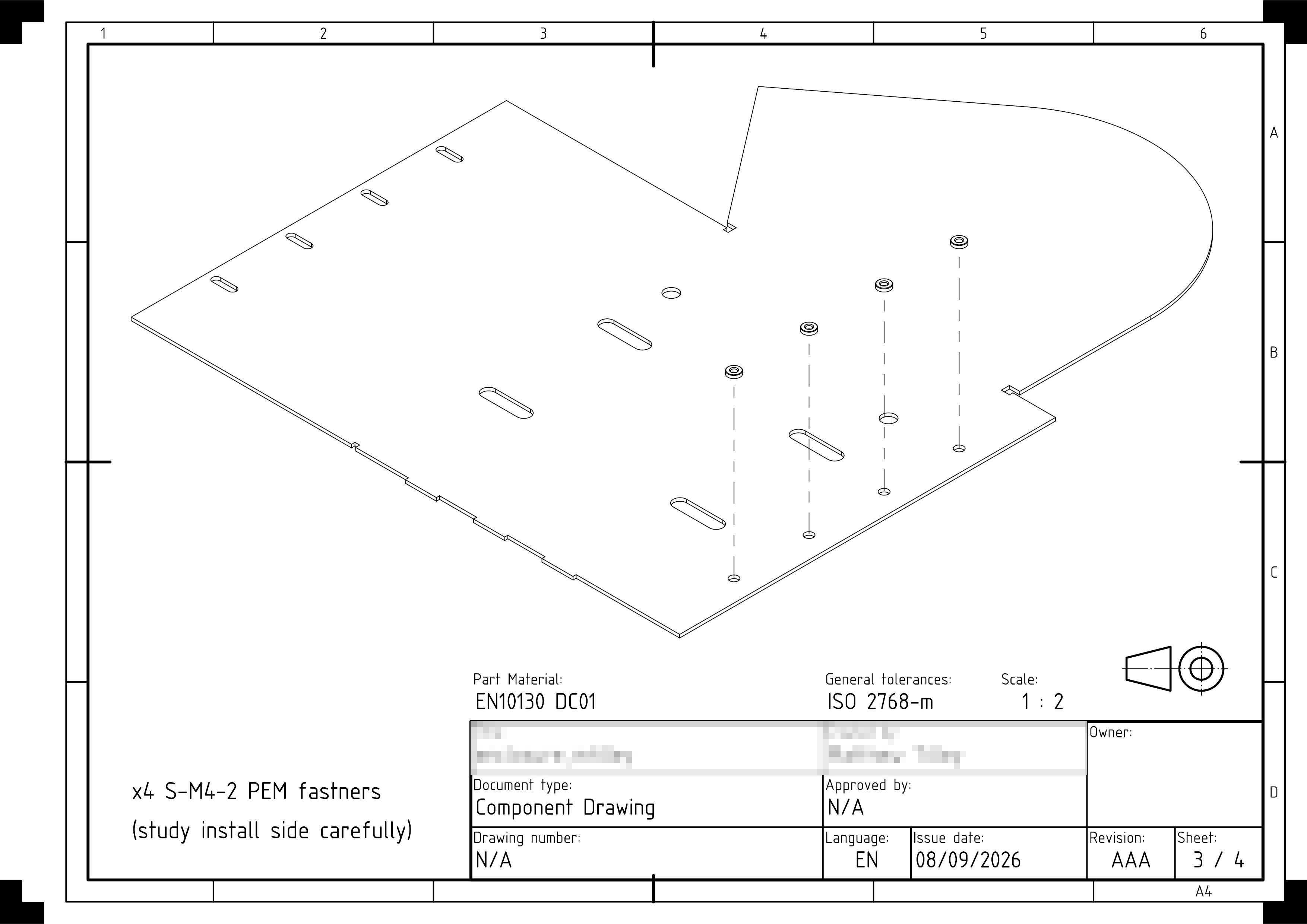

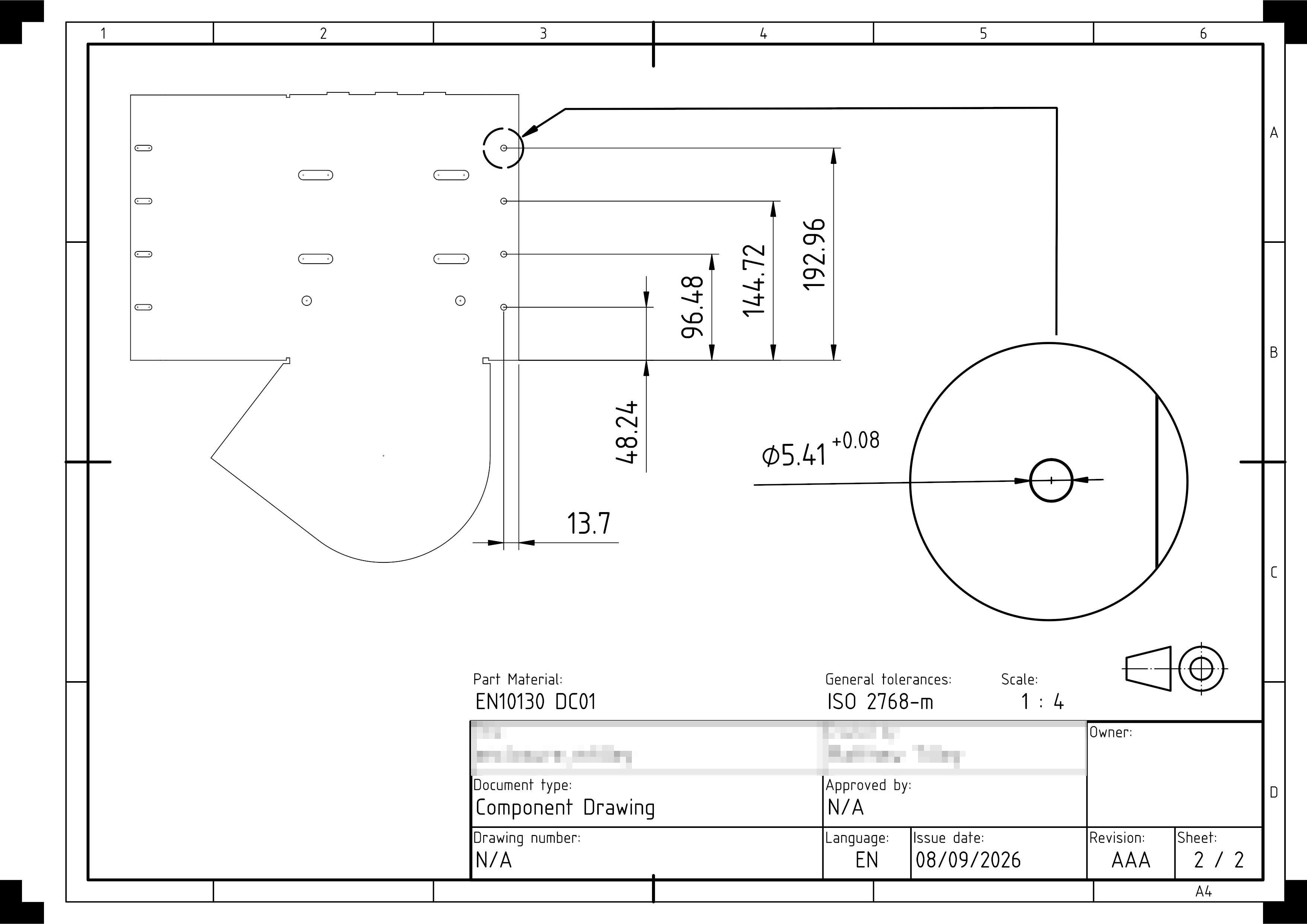

      Thanks! So to clarify, you’re saying that PEM indicate an overly conservative tolerance for the hole size, and the hole itself can actually be materially larger?
      The issue is that if the tolerance is too narrow to be held by laser cutting, I’ll need to remove the holes in question from my .dxf file and instead define them in the drawing; they would need drilling. But, in all of the material I’ve read through on designing for laser cutting, nowhere have I seen any suggestion that laser cut holes can’t reliably be used to install PEM inserts.
      I’ve included a couple of pages from the drawing below so it can be seen what I’m going for.

    • Xometry Engineer
      Hello,
      Great question, and you are absolutely right in your analysis. The +0.08 mm tolerance is indeed too tight to guarantee consistently with standard laser cutting alone due to the natural variation in the kerf width.
      To ensure your parts come out perfectly, we handle this in one of two ways, depending on how you prefer to receive your order:
      Option 1: Xometry installs the inserts for you:
      If you request us to supply and press the PEM inserts into the sheet metal, you don’t need to worry about calculating the exact hole sizes or tolerances.
      What you need to do: Just provide a 2D technical drawing showing the sheet metal, the exact locations of the inserts, and the specific PEM part numbers/codes you require. Our manufacturing partners will take full responsibility for sizing the holes correctly and installing the inserts.
      Option 2: We supply the sheet metal, and you install the inserts yourself:
      If you prefer to order just the bare sheet metal and install the hardware on your end, we can still achieve that tight tolerance. To do this, our partners typically use secondary operations (like precision drilling or reaming after an undersized laser cut).
      What you need to do: You must attach a 2D technical drawing (PDF) alongside your 3D model. Call out the specific holes and explicitly indicate the required size and the +0.08 / -0.00 tolerance. The 2D drawing ensures our quality control team and manufacturing partners know exactly what strict tolerances must be met during fabrication.
      Both options are available through our platform. Let us know if you need any help setting up your quote!
